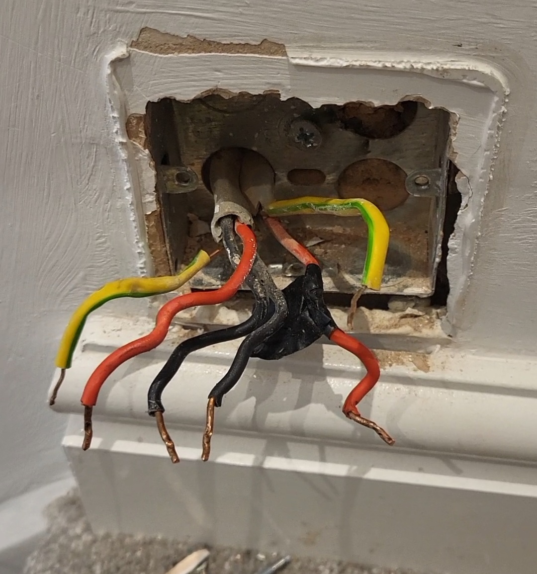

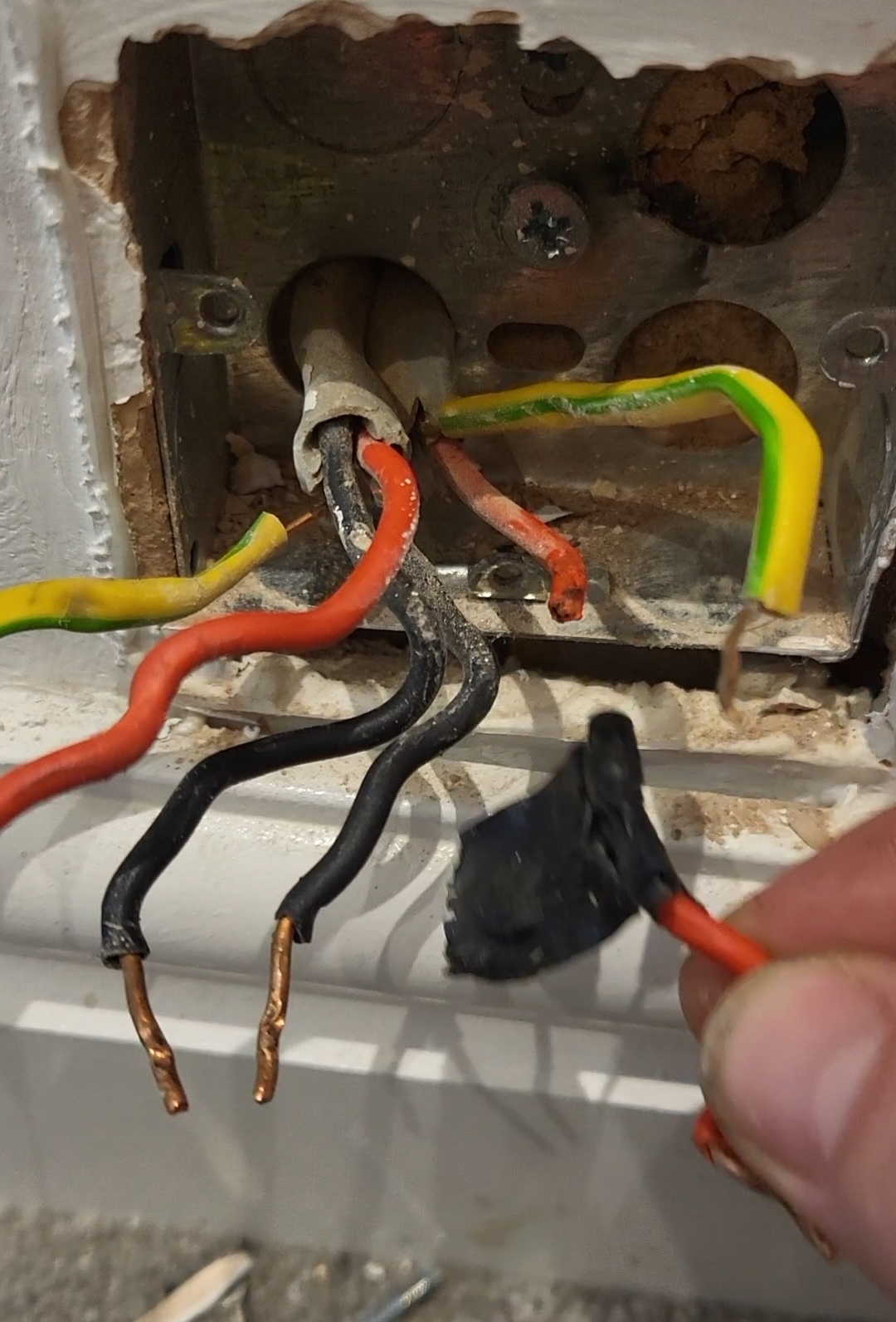

Adding a socket in my Daughters bedroom, had no end to end continuity on the line conductors.
After some fault finding, I found the cause. Just butted up together and taped!
I joined the line conductor with a Wago and also put a grommet in the back box.

I prefer to use the wago 2773 push fit in that scenario as there is no chance of the levers being pushed up when the socket is fitted.
I suspect that at some point the insulation had been damaged where the break is and the exposed copper shorted to a sharp edge on the back box or an earth strap on the back of the socket, blowing a sizeable chunk of the copper away. This had been taped up as a repair to the insulation, but the weakened wire has subsequently broken inside the tape.
