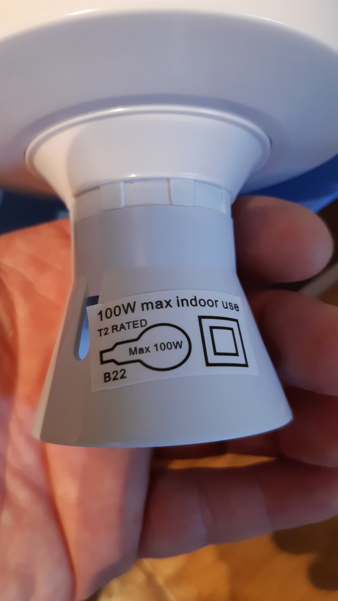

Hi All
I’m presuming a standard pendant is a class 2 fitting as the earth terminals are not needed as it’s a plastic fitting and it only has an insulated 2 core going to the actual ‘lamp part’.
Am I correct in thinking this?
The reason I ask is Screwfix have replied to someone’s question that it is a class 1 and requires an earth? Even though it is only used to loop in/out.
Can anyone clarify this for me.
