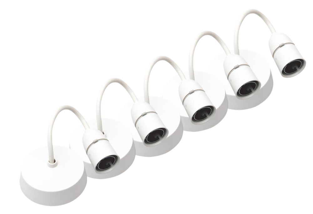

Hi All
I’m presuming a standard pendant is a class 2 fitting as the earth terminals are not needed as it’s a plastic fitting and it only has an insulated 2 core going to the actual ‘lamp part’.
Am I correct in thinking this?
The reason I ask is Screwfix have replied to someone’s question that it is a class 1 and requires an earth? Even though it is only used to loop in/out.
Can anyone clarify this for me.

Standard plastic pendant sets such as these have no exposed conductive metal parts, so the lack of CPC (earth conductor) doesn't make them any less safe in their installed state.
Wiring regulations require a CPC to every point, even to plastic fittings such as these, in case they should be changed in the future to class I fittings. So even if you change all your lights and switches to plastic, it will still receive a code, as it is non compliant.
Whether your inspector codes it as C3 (improvement recommended, but satisfactory) or C2 (potentially dangerous, unsatisfactory) is up to his or her own judgement.

Just spoke to NICEIC electrician and he stated these are fine as Class 2.
‘BG pendants have no exposed metalic parts and internals are not live unless you put a bulb in so they will be fine.
C3 if fittings are class 2. C3 if not.
consumer unit will need warning notice to say not to install metal fittings on lighting’
These fittings and again question asked/replied.

As Pretty Mouth wrote in post 33, there is no definitive answer to this, and it will ultimately come down to the opinion of whoever is conducting the EICR. I would have no problem with a modern pendant set (with earth parking terminal) used on pre 1970 wiring without a cpc, but that doesn't mean others wouldn't.
Cheers guys, i have also been informed that the Class 2 type MK/BG pendants have spring loaded pin terminals and only connect/make contact with the lamp in place. Again this obviously does not stop someone actually pushing the pins in i presume....
I will get some when i get chance, check them and reply back as someone above has stated differently.

I think this thread explains their use and my primary use for using them as they are class 2 and require no CPC, saves a very expensive/difficult partial rewire.

They suit my needs atm and both a JIB and an NICEIC electricians are willing to issue me an EICR with class 2 pendants (C3 with CU labelled warning notice to say not to install metal fittings on lighting).
This is a solution for me until the property is totally gutted/rewired some time later this year.
