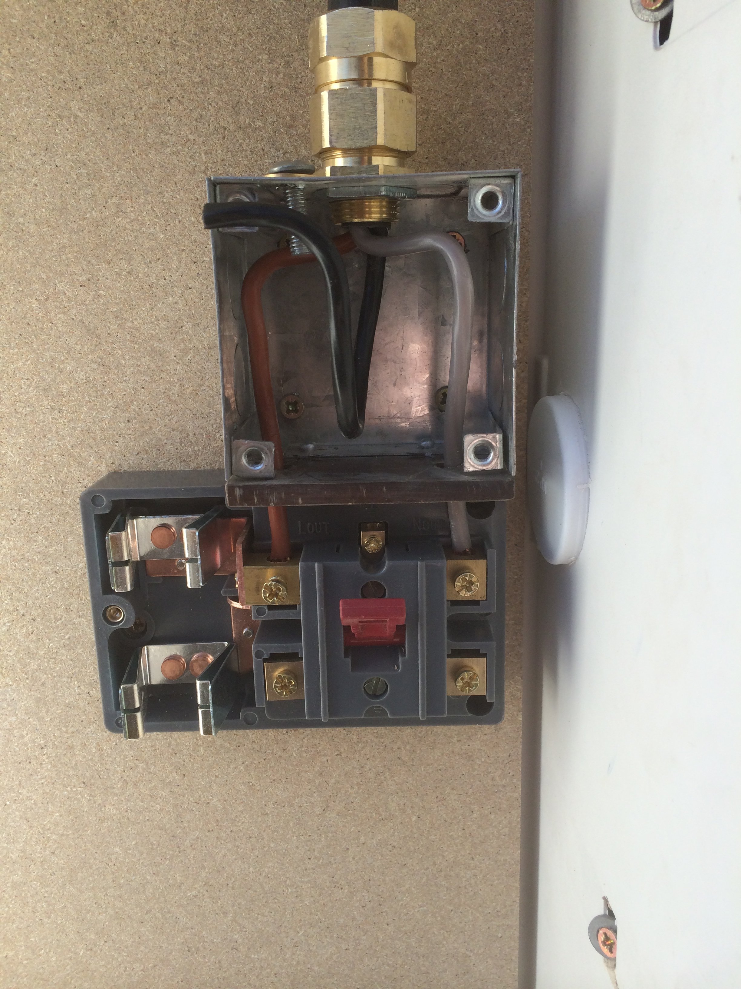

I've finally found some of the pictures i was looking for earlier. This job was done in early 2015 so had a completely legitimate plastic CU fitted.
This is what I mean about the flush box behind the CU

And this is the supply end in progress, I can't find any pictures of it finished but you get the idea, and the KMF is the right way up!

Ferrous box with live and neutral going through separate holes?
Edit going through timber or something else rather? thought I'd caught you out dave :)
