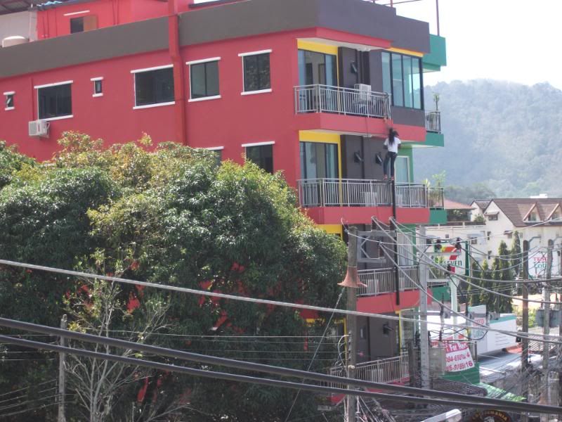

thailand has lovely electrics
and heath&safety-not
notice the guy hanging off the balcony by one hand , drilling fixings for the aircon unit
